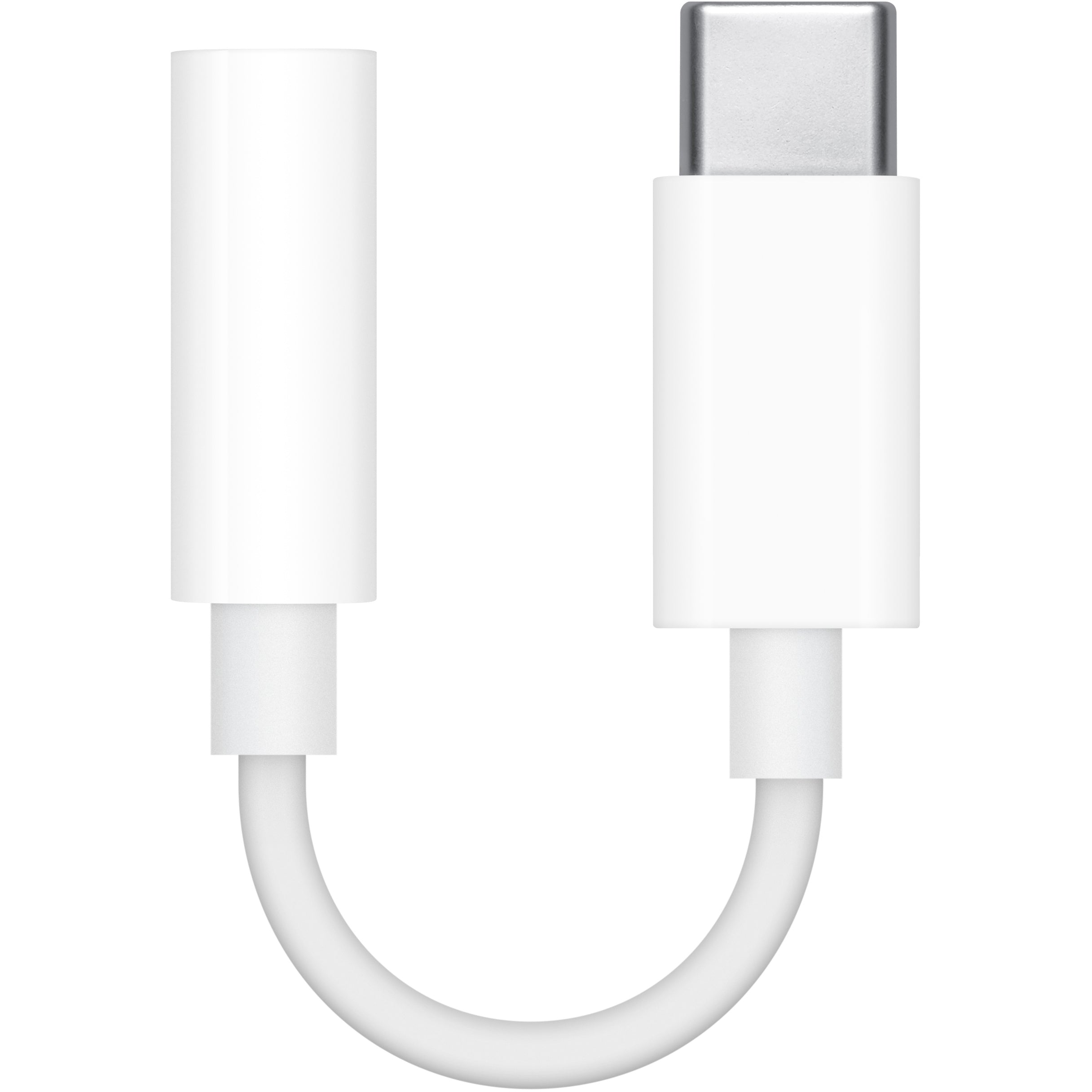

Sennheiser specify the HD 598 with 112dB SPL / 1 Vrms, so very sensitive and easy to drive.
The 1V from an Apple dongle will be way more than enough, plus the Apple dongle has great recording quality.

0.5 V without any cuts will give about 94 dB in low bass (where impedance rises sharply) on Sennheiser HD 598. Not enough for some peeks in calibration full loudness and you won't always have possibility to either skip or compensate for loudness algorithm used. Standard 2V should be enough. I would avoid Creative all together if you need ADC. Apple dongles require Android 16 to have their hardware loudness set to max (it's set low by default).
Please explain how you got 94dB
Looking at RAA graph plot, looking more closely up to 97 dB @ 56 Hz. Marginally enough to full loudness 12 DR program but really you want 2V so that you can afford to lose cuple (dB) at least.
Are you saying the Apple is also an ADC, or am I being really thick?
Edit: well **** me, it is! That makes it even more one of the great bargains in audio!
