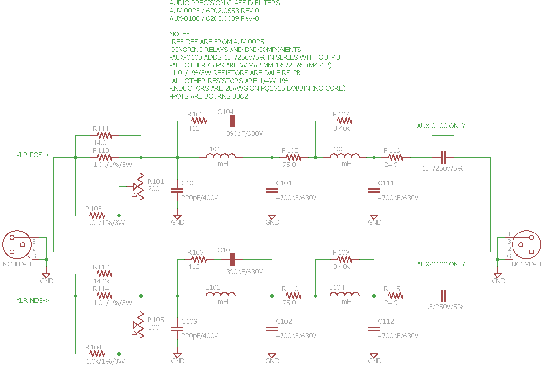

Before getting into that, let me introduce you to another measurement gear, the AES-17 filter. Both of these amplifiers are switching types and hence produce a lot of ultrasonic energy. This should be inaudible but my analyzer will see them and attempt to set its internal gain using it. Or else, causes what is called "slew rate limiting." In a nutshell, the analyzer input stage is designed to be "slow" but extremely accurate. It expects to see audio frequencies and not spectrum in Megahertz whaling away. For this reason, a filter is necessary to keep this extra noise at bay.
Audio Engineering society has specified such a filter with 20 kHz response with extremely flat response. I am not happy with chopping the spectrum so early so I purchased a 40 kHz variation from Audio Precision called the AUX-0040:
Here is its frequency response:
It is a passive device (much like filters in your speaker crossover) designed for extremely low distortion (read, air core inductors). Frequency response variation is +- 0.08 dB up to 40 kHz. In other words, it is dead flat for our purposes.
Like everything else from Audio Precision, this thing does not come cheap. It retails for nearly $1,600 plus tax and shipping. I was going to build one but good suggestion was made that it is better to use a known product from AP. This made sense to my head but my pocketbook has even a larger hole in it now!
