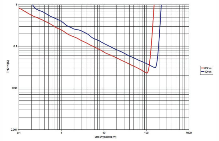

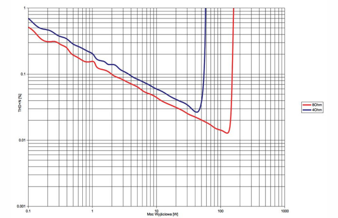

The old Denon AVR X3300W
https://audio.com.pl/testy/kino-domowe/amplitunery-av/2717-denon-avr-x3300w
YWRkPTY5OHg0NTB4ZmZmZmZm_src_44537-amplituner-av-denon-avr-x3300w-audiocompl-lab3.jpg
That is why I sent an email to the Polish magazine, commenting on the great differences in the THD measurements of the AVRs, asking them to review their measurement system. Silence after almost two months. :(
Well, that, now I doubt all your THD measurements, whether AVR or not.
Probably due to different methodologies. Audioholics, like Amir, also use the AP for their measurements so I suspect their methodologies are likely more similar than different.
Take a look of theirs on the AVR-X3300W and the weaker Yamaha RX-A860 and you'll see much different results than that Polish site.
https://www.audioholics.com/av-receiver-reviews/denon-avr-x3300w-1/measurements
One thing that stand out is, the Polish site use the impedance setting for the 4 ohm test load. That would drop the rail voltage and that's why the output dropped so much for the 4 ohm test. Soundandvision.com, Audioholics.com and Audiovision.de know better to leave the impedance setting at 8 ohm. The 4 ohm setting is a "cya" thing for the manufacturers. I will never use it.
