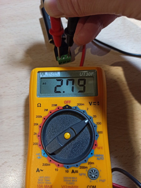

Going back to #9030D, the first thing I want to tell you is that the resistors used are 33 Ohms (3W), in the last posted image you can see its measure with the multimeter. I put it back so you can see it.

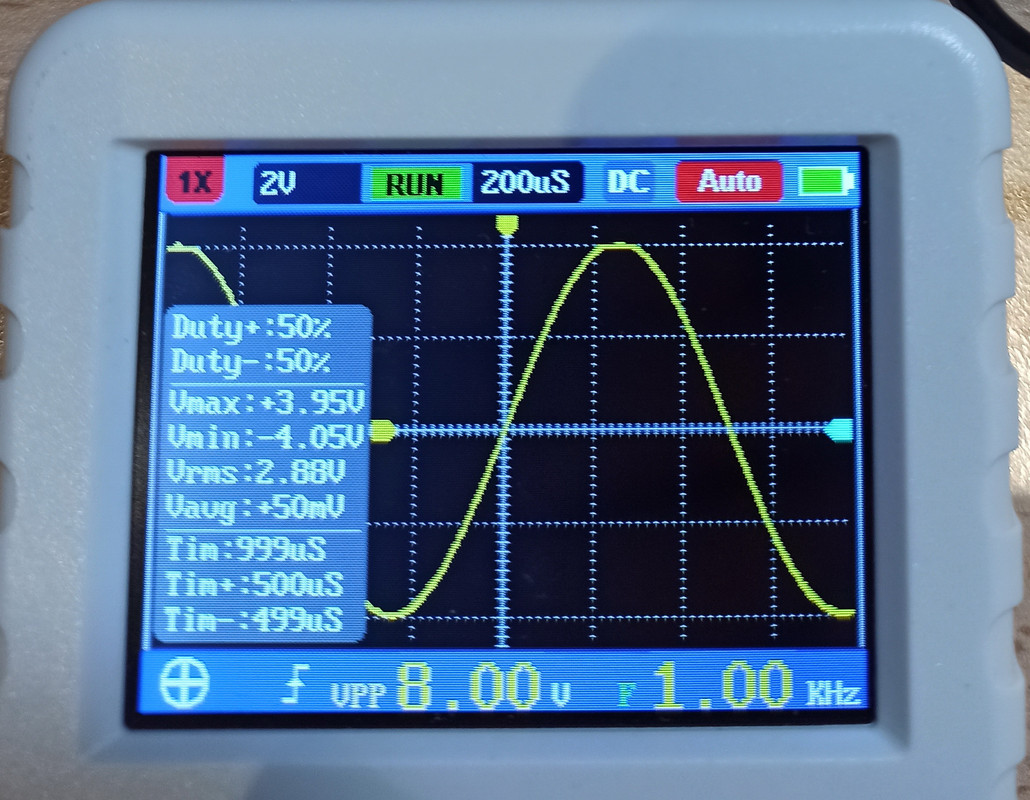

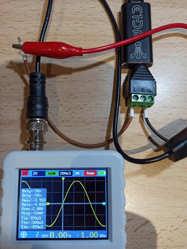

Now I hang the measurements made with No Load, both with the oscilloscope, and with the multimeter. For the multimeter measurement, I have used pure sine waves from 1kHz to 100Hz, because I know that the multimeter does not measure in alternate, beyond this figure. The measurement taken is stable in this range from 100Hz to 1kHz.
You can see that the signal is clearly clean.

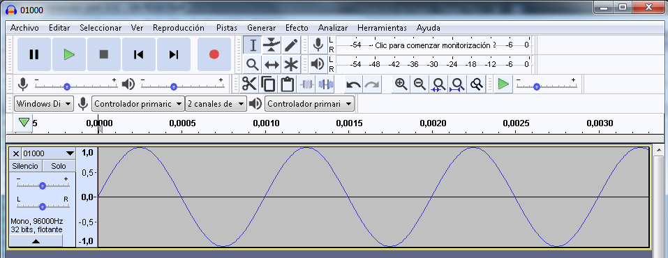

Another important fact is that I use Audacity to create the pure sinusoidal tones of amplitude 1 in mono, 96kHz FLAC.
