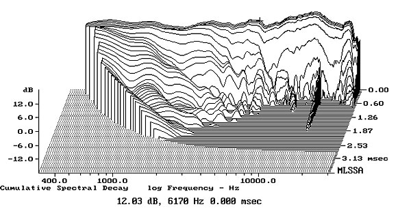

I don't agree with your assessment that the F226Be has flatter response, smoother yes but not overall flatter. And then there's the strange "ringing" of the 226/8's midrange cone.
souce: https://www.stereophile.com/
