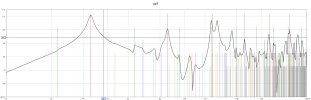

So. I have recently owned these speakers. It's an interesting experience. However, I have some difficulties with the low-frequency component.
I think the screenshots will explain the situation quite eloquently. The room is now almost empty. Both long walls are very thick and made of brick. Without an equalizer in the Wiim, this cannot be used. Unfortunately, the equalizer does not satisfy me, despite numerous attempts to adjust it. The bass is either humming or insufficient. At the same time, the bass is always sluggish and slow.
Please give short recommendations on suppressing room modes. I have no idea how effective bass traps are. Movement in the room is limited and does not give a noticeable result. Changing the bass reflex setting gave a positive effect. As far as I understand, the port is set to 40 Hz. This frequency almost completely coincides with the resonance of the room.
I would be grateful for short recommendations.
Finally, a non-trivial question. Don't you think the port is set too high? Look at the impedance graph.
