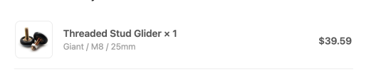

I recommend you use these to make them easy to move and protect the floor/bottom of the speaker
They require no burn-in at all, like most loudspeakers.
PS - in terms of screw/foot size, these worked on my F228be
