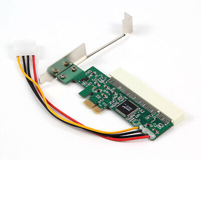

You can buy PCIE (motherboard slot) to PCI Drive Bay adapters. These will go in the space where a DVD-ROM would go and take two PCI cards. The M-Audio AP2496 would then move to the front of the PC which is cool.
But, not sure if you could hack the Win Vista 64 drivers to continue working under W11. They do work under W10.
Coming back around to this, I found this adapter which is quite cool as it steps the PCI card back away from the rear of the case so you'd have room to connect the cables through the back as per usual. Only possible issue is that the card is not supported - maybe could bend one of the blanking plates 90 degrees and screw it upside down to the case so it projects back to the PCI card :)
