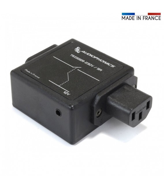

Mount something like this into a nice enclosure and get PDUs that can be triggered via 12V. Solder 12V power supply to the switch. No risk of working with 110/220V and you have a nice switch.

There is also the question whether the device will come back on when power is restored. My March Audio amp for example doesn't, its power supply requires the front power button to be pressed. Alan suggested using the trigger port instead. I'm now keeping the amp connected to the mains permanently and use a cheap 12V power adapter on my WiFi-controlled outlet. Seems like an ideal solution to me, especially since the power adapter can be shared to trigger multiple devices.
