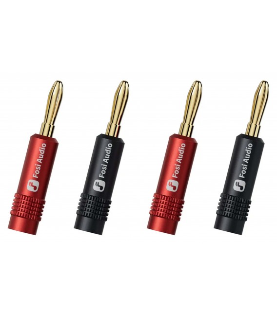

Has anyone experience with the Fosi Audio Banana Plugs? They seem to be gold plated copper.
Are they magnetic ?

I strongly advise against using these types of connectors, as the contacts are made of thin sheet metal that fatigues very quickly, has little tensile strength, and therefore doesn't make good contact.
Almost all connectors are slightly magnetic, even if the manufacturer claims otherwise. This is due to the necessary nickel plating under the gold plating (or rhodium plating, etc.). The exception is the very expensive WBT connectors.
I recommend genuine hollow banana plugs, expandable and lockable banana plugs, similar to those from WBT and the Audiophonics Banana Plug Gold Plated Copper Ø5mm (Set x4) or the YYTCG-Connector Corrosion resistant banana plugs, audio, video, amplifiers, speakers, cable jacks, 4Pcs from AliExpress. They are also available in rhodium-plated. These types have very good contact quality. The low price is another bonus. Don't forget insulation.
