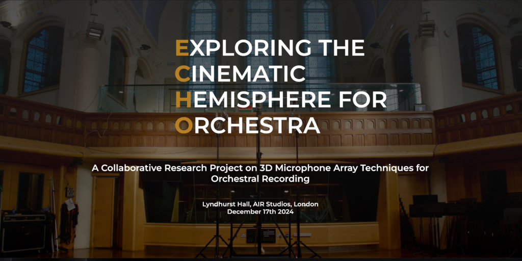

On the recording side, there have been approaches for years on microphone placement which have been up-converted to spatial. There are many projects and approaches to hall-specific microphone setups.
ECHO is a new collaborative: Exploring the Cinematic Hemisphere for Orchestra. AIR studios are famous. ECHO was at AIR.
I don't think they have enough microphones or cables. :)
