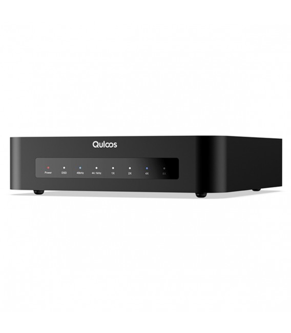

I did see that some DDC's like the QULOOS QU02 can do 384Khz on the coaxial RCA output if i read their specs.
Is this false advertisement? Because i tought optical only goes up to 192kHz max.
All the info is right there on the product page:
Coax != Optical
So why don't you?
Coax != Optical
Yeah but why have optical and coaxial not the same sample rate if they are the same? That was my question. I thought the maximum was 192kHz for optical.
As you can see, it is max 192 kHz for the optical out. At a higher sample rate, it will probably just be silent.. That is fairly standard. The optical transmitters/receivers and cable materials just do not support higher sample rates reliably. So why limit the coaxial output as well?
