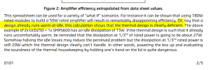

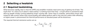

There's a nice paper by Hypex about it,here's some parts of it:
Full paper with the calcs needed for 1/3rd and 1/8th of rated power examples here:
