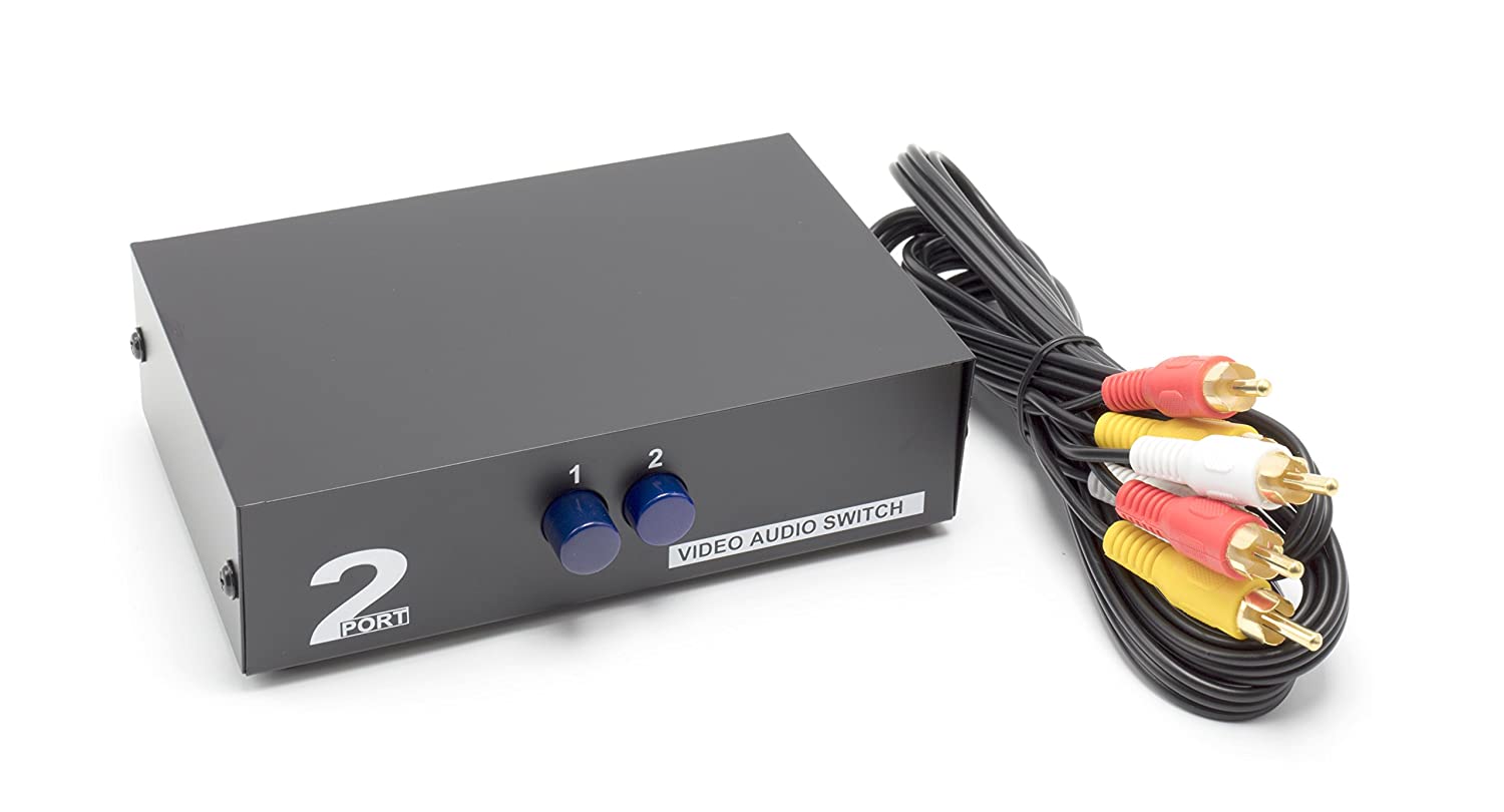

Something like this would work:
Just ignore the video jacks.
In my case I WANT to use them, but for switching coax S/PDIF
Composite-Video AV "yellow RCA" (RG59, 3G/6G HD-SDI) shares the same 75Ω impedance specs
e.g Belden 1694A or 1505F is recommended for composite video, S/PDIF Coax use (plus RCA analog audio!)
So, I'm thinking such a cheap push-button Composite-Video AV switch could maybe be used for manually switching between S/PDIF Coax sources?
