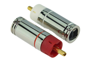

Here’s the posted link to RS Audio RCA plugs
Huh. What a weird design. Plastic ground? So there's only a small metal tab inside? And what the hell is that strain relief, a grub screw pushing into the cable mantle? That's prone to develop problems.
Good example of overfancy design that brings nothing but downsides. Avoid :D
Well am glade you were honest with me. I would have never would have guessed this about the strain relief. I didn’t buy them so am in good standings.
Well it's easy to be honest because plugs are simple things. There's some shell there the screw is pushing on, so not on the cable directly - still that's a weird lopsided result leading to mechanical stress and potential failure point. Strain relief is an essential part for durability. It's supposed to grab and surround like a hand, not be a pointy thing, so that bending forces into any direction get distributed evenly.
The keli RCA Plugs are made like these and so is the Aero plugs too. I will stay way from them for sure.
I think am going to go with the Neutrik NF2C-B/2 Profi Professional RCA Plug Pair. It has a nice stain relief and is probably the most I will spend on an RCA plug. I have some Dayton Audio 4 % silver solder I had left over from a previous project. Unless there’s a better built RCA plug for around $11.19 a piece. I like the features on these plugs a lot. Jeff

Never had an issue with the cheaper neutriks. Wrap a bit of electrical tape around the pin connection after soldering if you’re worried about shorting it to the sleeve. I do agree soldering that sleeve with the pin in the way can be tricky.
Those do look nicer to solder than the less expensive ones.
