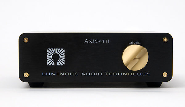

Re: Soundsource, since it's software, I assume there's no impact n the audio signal apart from vol and eq if desired?
Would this be a solution?
Yes, though way overpriced.
Personally I'd buy either a <$50 passive attenuator, or a Topping L30II.
Though if you don't mind spending $200+, for $50 more than the Axiom you can buy the Toppings L70 which has a resistor ladder volume control, remote control, volume display, and it'll convert the Qutest RCA Line out to balanced XLR.
