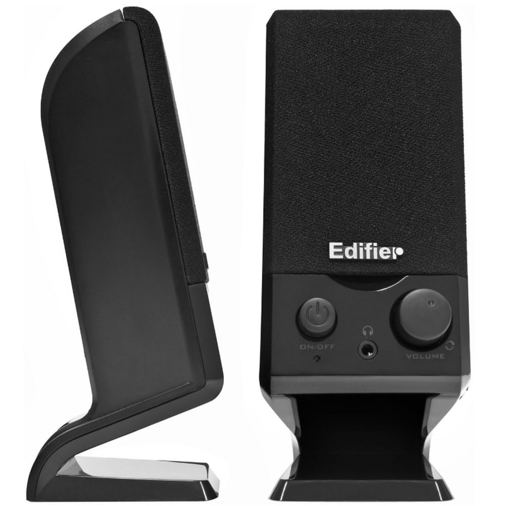

On my PC, the sound connections are: ASRock B75M-DGS R2.0 motherboard audio output/Edifier M1250 speaker/in-ear headphones, any model, for example KZ EDC Pro. Is there any loss of sound quality until it reaches the headphones? Is the sound card on this motherboard good enough to provide maximum performance to the headphones?

in-ear headphones, especially BA drivers, generally perform poor with onboard sound because 1) High noise levels 2) BA drivers have high impedance variation with frequency, and onboard sound / sound cards have high output impedance if it is labelled "line out" and not "headphone out". That being said, some motherboards / laptops do have headphone out / line out combo jacks, but even then the output impedance is a mess, so as said in paragraph #1, none of us really know without testing.
As for the headphone jack on speakers, often (I HOPE) it is positioned behind a buffer behind the volume control so you can adjust the headphone's volume, but I'm pretty sure there are oddball products which connects the headphone out directly to line-in. In any case, the output impedance of the headphone out is often again unspecified.
Ultimately, if you can't hear a difference, it's good enough. Even in some cases where you can hear a difference, like using my old PSP's headphone out with BA IEMs, I can live with it. Especially considering any "proper" solution to fix tiny problem will cost more than your M1250.

sequence: motherboard audio p2/edifier m1250/kz edc pro
- 5.1 CH HD Audio (Realtek ALC662 Audio Codec)
Edifier M1250
Edifier M1250
