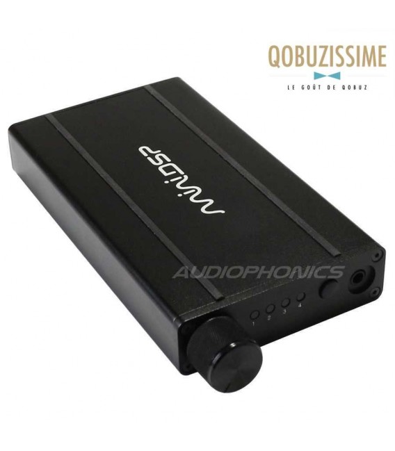

Hmmm. I think I might have found one.
Could you please verify it is what I think?
A friend just suggested it
MINIDSP HA-DSP 400MHZ SHARC DSP XMOS ES9018K2M​
FYI - That unit went End of Life in 2021...
Yeah i saw that. I did some research and found one on some online shop but 400+ bucks ist a bit steep for what i want it for.
Especially with no support from the company anymore. But based on the specs it looks nice.
Long discontinued, if you can find one used the battery's likely shot, but yeah. Would work.
