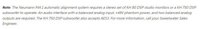

MA 1 allows you to store multiple alignments, so he could take and save measurements while at the desk MLP and take and save another set with the mic placed further out into the (neighboring?) room. In doing so he could theoretically load one alignment while he's working away at the desk and switch to the other for when he's lounging further away. One of the two is still going to be much more compromised than the other, however, as without moving the speakers each time he moves, there's no way to avoid being way outside of an equilateral triangle.
Theoretically, but...
The implication is that if one uses the MA1 software, changing anything requires an active Ethernet connection to the speakers..
I just saw a picture of the MA1 that shows it has an XLR connection, not a USB connection. Here's what Neumann has to say about how the process goes:
"Simply connect"...except that the OP doesn't own an audio interface that connects to his computer with balanced inputs/mic preamps that supplies phantom power to the microphone (which is noted on the Sweetwater site as necessary to use the MA1 and associated software.)
Once the MA1 software does its thing, and the user loads the configuration, then the Ethernet cables can be disconnected--but then there's no way for a new configuration to be loaded. Only one configuration can be stored in the speakers.
Oh well, it's only money, and time required for the next learning curve, eh????

Theoretically, but... View attachment 275257 The implication is that if one uses the MA1 software, changing anything requires an active Ethernet connection to the speakers.. I just saw a picture of the MA1 that shows it has an XLR connection, not a USB connection. Here's what Neumann has to say about how the process goes: View attachment 275259 "Simply connect"...except that the OP doesn't own an audio interface that connects to his computer with balanced inputs/mic preamps that supplies phantom power to the microphone (which is noted on the Sweetwater site as necessary to use the MA1 and associated software.)
Yup, I used a Focusrite Scarlett Solo as the audio input. It worked fine and wasn't expensive - but it's indeed another item (along with the necessary cables) to add to the grocery list.
As my speakers are used on a desktop and I don't need the switch ports for other things, I have no compelling reason to disconnect the network cables, so it's easy to swap alignments if desired. If the OP is looking for good fidelity at multiple positions and at significantly variable distances in his room, any pair of stereo speakers is going to be seriously compromised at one position or another. You're well into the realm of seeking out "the lesser of all evils" in that case, and being able to swap alignments relatively quickly could potentially be useful.
