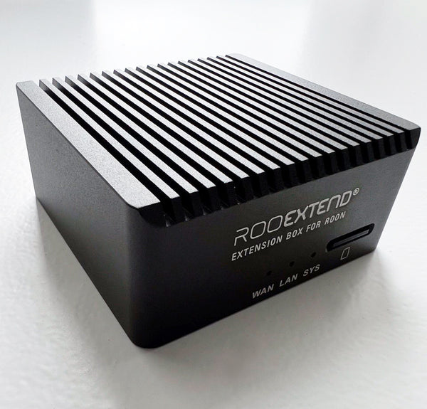

This is an analysis of Raspberry Pi4 USB signal quality to drive a budget but good DAC without impact on its performance. Traditionally it is thought that one needs a high-end "streamer" to accomplish the same.
Member @DrCWO kindly sent me the above platform for testing. It is a standard single board computer RPi hardware platform with his "RooExtend" Roon image which makes the device an end point for Roon player. This allows Roon to stream (push) content to it just like any other streaming platform. The very attractive hardware/enclosure is from his partner company, audiotra.de.
For testing, I selected the Topping E30 II that I had sitting around which at the time of its review cost US $149. I will be comparing its native, i.e. direct connected over USB, vs remote network (Ethernet) connection through RoonExtend.
Note that I used an independent power supply to drive the Topping E30 II. The RPi/Rooextender was powered using a random 1 amp USB-C adapter I had sitting around (I was also able to power it from my computer's USB hub).

Excellent performance but maybe you would want to include its price of 400€ on the review as its quite higher than of a normal Pi, guess a big part due to the Roon licence?

The question is if that hardware gives the same output as a Pi4 without it or has some voltage/signal conditioning, maybe @DrCWO can shed a light there?

It is just a box (plus software). What is inside is plain RPi4.
I'm not sure it is, it appears to have two NICs...
This along with the square form factor, makes me think this is a Compute Module 4 on a on a 'router board'. I don't understand the need for dual NICs on a Roon endpoint, but it does look like a nicely put together piece of kit.
*edit* Actually, the DUT looks a little more like a standard Pi, so maybe there is more than one version of the Rooextend?
To be clear, RootExtend is just software. The supplied hardware is an example product running it as a turnkey solution.
That aside, I am told that this is standard RPi4. I am assuming dual NIC comes from an additional HAT.

It certainly doesn't look like a standard RPi4 in a box (where are the USB ports, why are there two LAN interfaces...).
Unfortunately, until there's more information about what actually is inside the box, there will be claims from the usual quarters that "obviously a standard RPi would not sound as good, the solid enclosure clearly helps to reduce the noise floor" or whatever.
