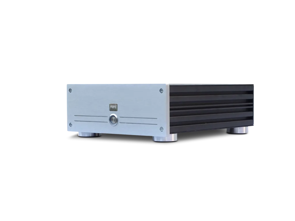

Exactly, especially considering it's their last model. I'm not willing to put up with that in 2026.
1.5v! Crazy
1.5v! Crazy
It's probably a £1500 amp!
You can get better for less.
I should get a Benchmark AHB2 or move away from class a/b amps altogether.
At least £3300 if you are in the UK, for an AHB2.
Good measurements, but only 100W/8 ohm.
A class-D for half the price will have way more power, and have SINAD considerably above anything you are capable of noticing, and not far off the AHB2.
Or, look at the Topping kit if you need something from the top slots in Amir's reviews.
I have a Quad Vena powering a pair of Harbeth P3 esr’s and there is a noticeable pop following a noticeable click of the relays. Using the same monitors with my smsl monos there is total silence on startup.
For the same money as the Artera Stereo power amp, you can get two Hypex nilai 500 diy mono kits from kjf audio in the UK here. If the smsl’s ever go west, then this is where i will sink my cash next.
