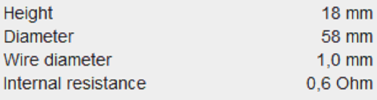

Thanks ! I'm looking to purchase an inductor to make a crossover, which will be put into a speaker to use with the quad 909.
The inductor has the following specs :
Do you know what is meant by internal resistance in the specs. I thought the inductor's resistance is always changing with frequency and is usually called inductive reactance rather than resistance
It's DC resistance, AC resistance is impedance. Generally very low impedance in higher frequencies isn't that problematic, but at lower frequencies it might be.
Thanks ! Does that mean the inductor will add 0.6 ohm resistance at all frequencies

Isn't it DC resistance? It also depends on where the coil is in the circuit.
Okay, but if 0.6 ohms is the resistance of the wire used to make the inductor then that 0.6 ohms should be at all frequencies ?
