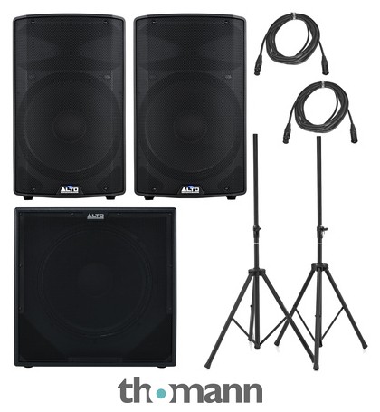

PA
Minimum: 2×12“ tops + 1×18” sub
Recommended: 2×12“ tops + 2×18” subs
If you enjoy it, you can build it yourself. But stick to tried-and-true designs, there are a lot in the market. There’s no point in experimenting without any experience if you’ve never done a self construction of a Loudspeaker before.
If it were just for you at home, the result wouldn’t matter and you could experiment, but as I understand it, you want to share the music with others—so it really should sound good.
In any case, I get annoyed when I have to listen to really bad sound somewhere that could have easily been prevented and improved.
PS
I don't think you can build it yourself for that price, including the amplifier circuitry.
Something like this—or rather, with that much driver area—is the standard setup for a room of that size.
This is a budget product, but it's still much more useful than those Lii things.
PPS
They have some pretty knowledgeable consultants at Thomann. If you tell them what you’re planning, the size of the room, etc.—and what you’re hoping to achieve—they’ll find something that fits your budget. If I were you, I’d just give it a try; you can always build it yourself if it doesn’t work out.
And no, I don’t work at Thomann and I don’t get a commission—but those guys really enjoy their work.
