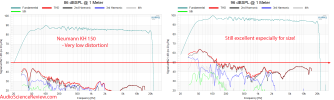

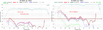

Enjoyment is subjective, but greater transparency is certainly possible, and for half the price at that:
PSI Swiss Made Professional Pro Speaker Monitor THD distortion Measurement.png
Neumann KH 150 two-way studio monitor speaker active THD Distortion Measurement.png
PSI Swiss Made Professional Pro Speaker Monitor step response Measurement.png Neumann KH 150 two-way studio monitor speaker active DSP Step Response Measurement (1).png
PSI Swiss Made Professional Pro Speaker Monitor CSD waterfall Measurement.png Neumann KH 150 two-way studio monitor speaker active CSD Waterfall Measurement.png
It's important to have in mind that the measurements here may not reflect what was measured at the factory because the acoustic axis used for this dataset is different from the specified on the datasheet. The distortion graphs are still reliable, but the on-axis and step response graphs are very likely worse than what the company calibrated.
