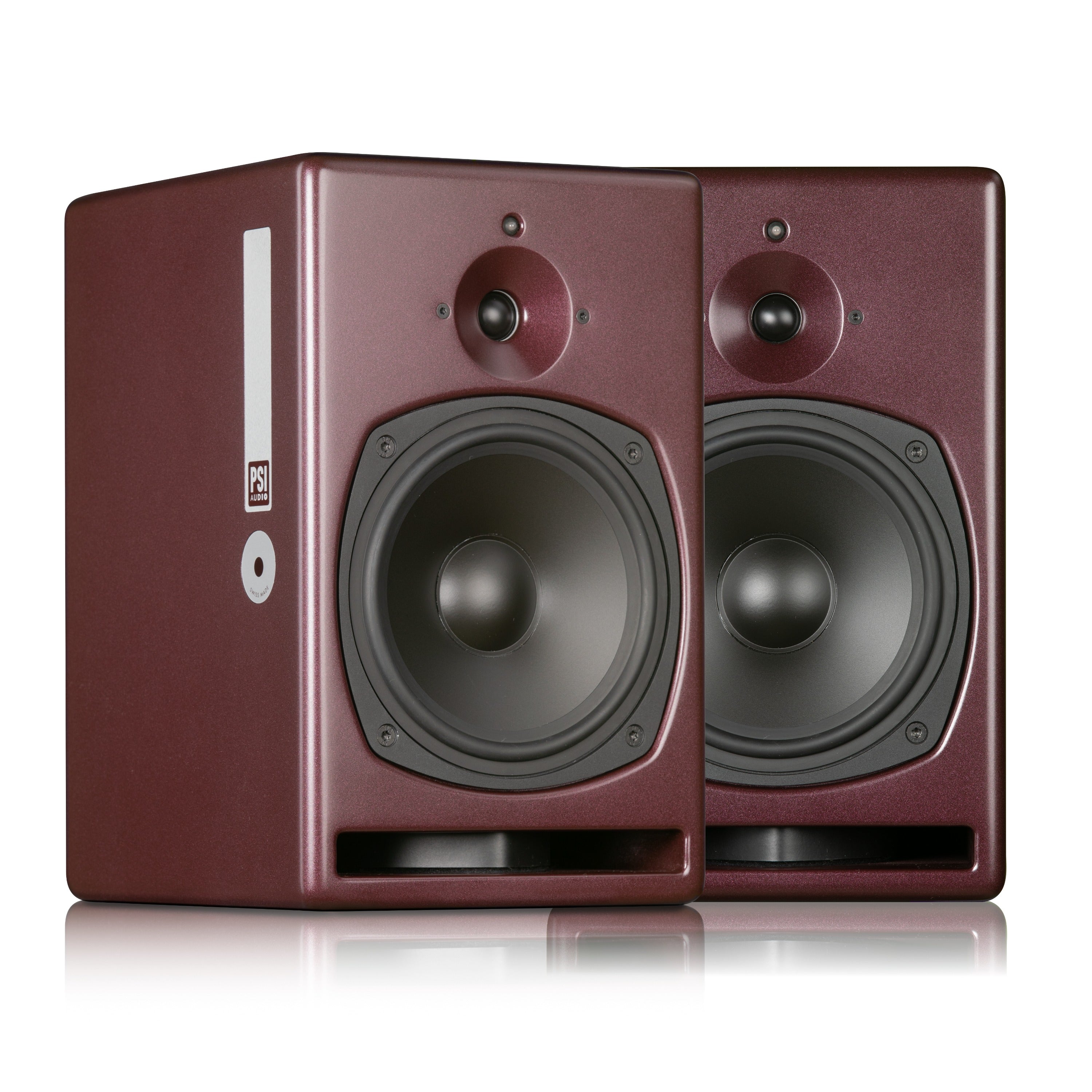

I made near-field measurements but forgot to do so with the port
Would you have the opportunity to make up for that? It seems that a little brainpower has gone into the port contour after all:
I voted great, measurements are super nice regardless of price, which we all agree is not a good value.
Lack of DSP means zero latency. The down side, and it is a small one, is inability to make the small corrections I made with EQ. Dial that into your DAQ (or music player in domestic listening) and you have an excellent speaker.
As you say, the lack of built-in DSP often means low latency, which is very important in audio production. And as this speaker is meant to be used in a music studio, there is hardly a lack of EQ capabilities in such environment anyway. :)
not really.
people buying this are likely into Swiss-made, or the look, or both. With them objectively better and cheaper do not mean much.
You're probably right. The build quality seems very good, and without the "gunk" all over the PCB.

Not for me, but still a great product for those not in the "best bang for the buck" market segment. Nothing hand-build in Switzerland will ever by price competitive.

I don't know how to say, but this is the measurement of KALI LP6V2 from Erin's Audio corner, which costs about 400$ for a new pair in my country.
You are missing 20 Hz worth of extension at the low end. That makes a big difference subjectively.
Thanks Amir, I was keen to see this test. I'm probably unusual in that PSI Audio have been on my radar for a while.
Like them, I value phase linearity a lot. They even have a specification for it "± 45 (250 Hz – 20 kHz)", like recent Neumann models. "105 Hz ... 16 kHz; +/- 45°".
PSI are different to Neumann, Genelec, Kef, GRIMM etc because the signal processing / correction is analogue.
HOWEVER, their claimed SNR varies from 95 to 103 dB across the model range, which is disappointing.
Phase compensation inevitably adds latency, so their claim for low latency is misleading.
Finally, your step response test shows that PSI haven't been as successful at getting both amplitude and phase response linear as Neumann.
I'm grateful for the objective review! I've always wondered how these would measure.
I demod a pair of these last year at my place after seeing that Rob Swire (Pendulum - incredible engineer) uses PSI.
They sounded fantastic, but for £5.5k I'm not sure on the value to performance ratio.
That's a very antique looking setup, with all separate DIP-opamps. How old is this model, must be 20-30 years?
As well as swiss gear is built, the value for money is gone out the window with their gear. It is made to induce the feel of exclusiveness (Swiss->Banks->Rich->High tech) but the asking prices are in general rather crazy. Just look at the offerings from Nagra or FM Acoustics for example.
Still it's an achievement to get them this flat without DSP. They probably use analog filters.
