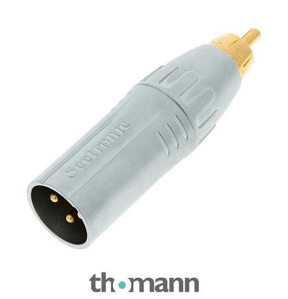

Can you recommend such adapters? I'm currently experimenting with the Monoprice cable and would like to test these adapters as well.
The Monoprice cables are fine if you observe what KSTR said. RCA on the source end and XLR male at the opposite end.
So you can't recommend any adapter
Then run an XLR cable from here to the power amp or other device.
No please notice, the one you linked to is the wrong one. You don't want to use that one. You want male RCA to male XLR. Notice in your adress it is ma3frf (female to female) and KSTR's and mine are 3MRM (male to male). Thank you for trying to help, but you need to switch links to the correct adapter.
Yes you can remove the period at the very end of KSTR's link and it works.
Gosh, I didn’t watch the endings, just saw the suggestion in Thomanns site when tapping “seetronics xlr to rca adapter”. I delete the post, thanks for correction! :)
