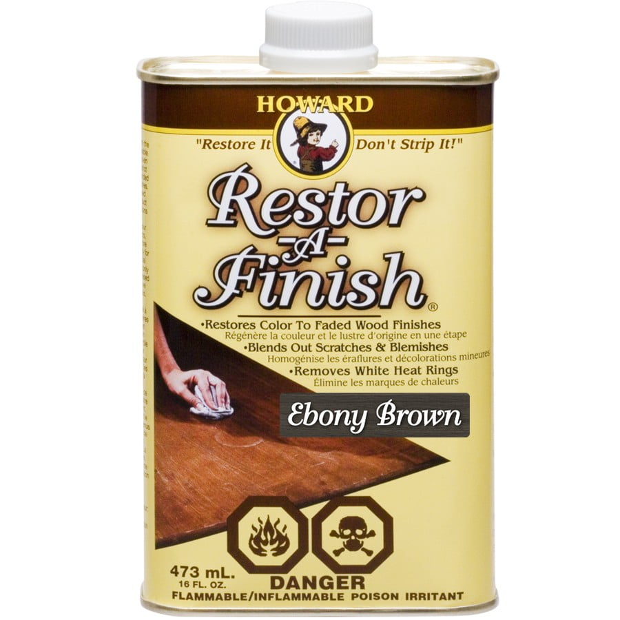

Howard’s Restore A Finish
You can get it at Home Depot or Amazon in oak, walnut, cherry etc.
the rub on beeswax you apply after can be buffed

FWIW, the Howards products are much-admired in certain circles (ahem, see, e.g., AK, ahem). In full disclosure, I've used the Restore-A-Finish and Wax-and-Feed and they are a quick and easy way to make a tired (oil) finish look presentable; much beloved of eBAY and fleamarket flippers. :facepalm:
I can say from my own experience that the Howards products (specifically the Restore-a-Finish products) make wood look pretty good for a fairly short time.
The Watco stuff I mentioned above seems to me to be much better. I've used it on some nice but very faded (and even water-stained) furniture with good results for up to a year (to date).
Mind you, I am no expert on this stuff -- indeed, no expert is a mammoth understatement. :eek::facepalm: BUT, I do know some folks who are experts (i.e., pro furniture refinishers who do very fine quality, and expensive, restoration work). Empirically* they revile the Howards products. I suspect they'd scoff at the Watco rejuvenator, too :confused:, but, empirically, it is pretty good.
