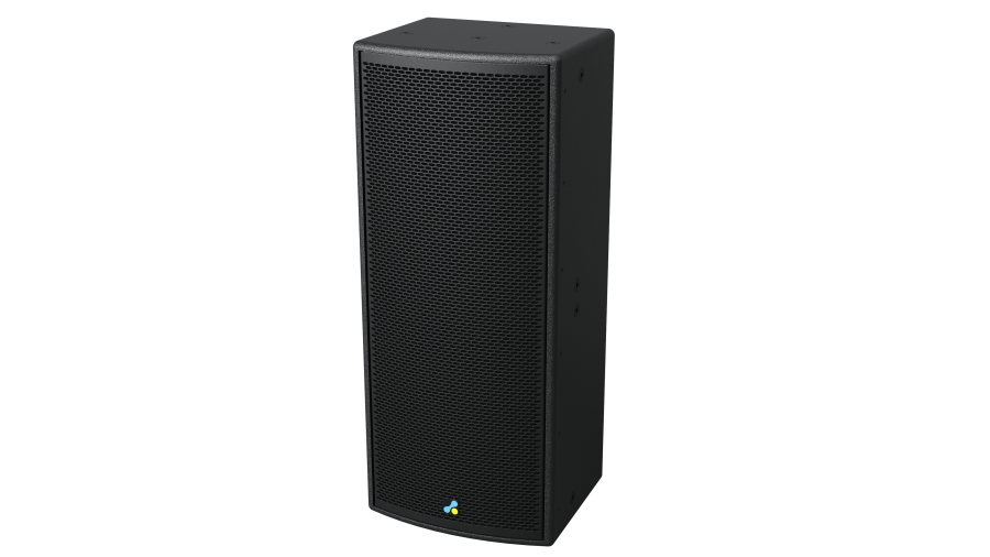

This is probably the cheapest mass consumer loudspeaker product attempt that has Dave Gunness' design input. The FR performance of their coaxial speakers do vary quite a bit from one to the next since the drivers and horns used are not at all completely identical anyways. Some commonalities with the more professional Fulcrum PA line is about high SPL output packaged at relatively small, rugged designs (which is easier to maintain long-term and minimize visibility for fixed installations). From that vantage point one can see why the use of "pro audio" horn coax drivers have been preferred at Fulcrum Acoustic.
They also make relatively cheap PA gear
I have a pair of the discontinued SL328AI
They are truly not hifi but they do go loud
The larger PA stuff were discontinued by Presonus only after a few years... but, very similar and improved design of the above is here:
