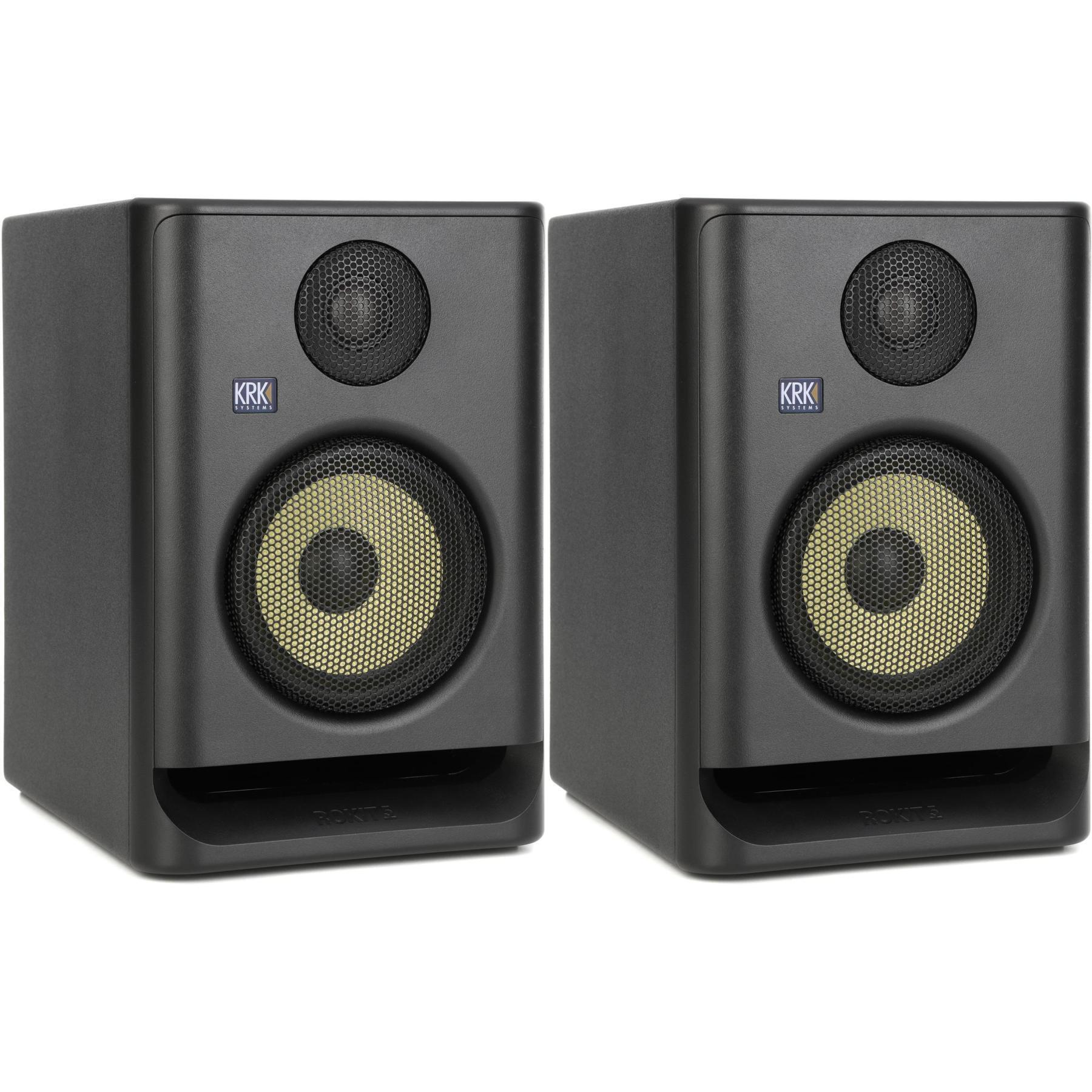

If you’re on a strict budget but like/need deep bass then i suggest KRK Rokit 5 monitors and the KRK S8.4 subwoofer, I’ve owned various KRK monitors/subs over the years and never had issues with them at all.
If they’re too expensive then there’s decent options for monitors on sweetwater link, just search by price
