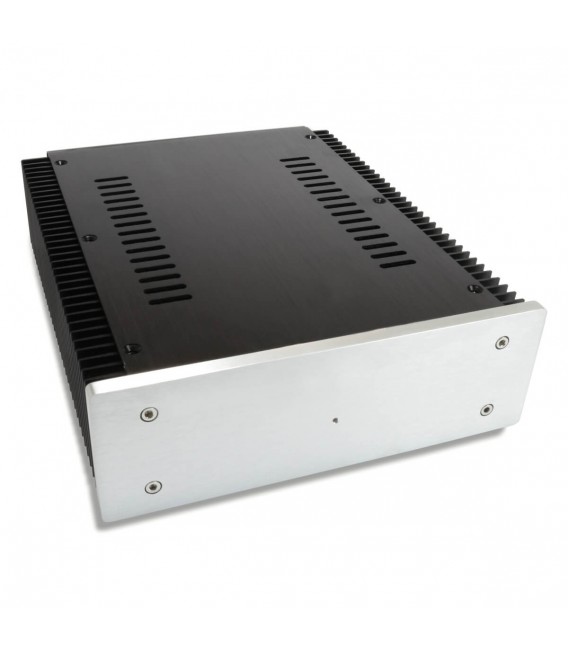

This product from Audiophonics in France is said to support, for example, an Intel NUC with clean electricity. I recently read in another forum about a person who, despite his own great skepticism, in an A/B test found that it gave a clearly better sound when his NUC with Roon Rock was fed with this power source instead of it's regular switched aggregate. But is this even theoretically possible? I can understand that computers often have dirty electricity out of their USB ports, but is this dirt not generated in the computer itself? Isn't this with a separate power supply to the computer not to attack the problem at the wrong end so to speak? (I completely disregard the fact that a good DAC ought to be immune against dirty electricity carried over via USB)
Does this product and other similar have any function at all, and if so which - provided it really does what they state that it should do?

Depends on what the rest of the system looks like. If there's a ground connection there and the NUC's power supply's leakage current with all the goodies from the mains filter makes it down your unbalanced interconnects, then I can very much imagine that it would make a difference. If the NUC connects to a balanced DAC which in itself is an IEC Class I device, then rather not.
The supply certainly looks very neatly constructed.

I'd like to see details of the testing as I doubt it fulfils the standards we expect for reliability in listening tests. As @AnalogSteph said, the system details matter too. It is unlikely the cleanliness of the 19V line will contribute much to performance as it will go through internal switching regulators to step it down to the voltages actually used by the computing parts.

The 19v from the PSU is probably not used directly anywhere in the NUC. Instead it's fed to a myriad of different small switch mode regulators.
The PSU has little to no influence on the final amount of noise. The PCB layout of the components in the NUC and the on-board filtering of the supply voltages and the signals most likely does all of the work.

Yes. I assumed this is the case. But to me Audiophonics is not associated with BS HiFi, so I was kind of confused. I asked myself, have I missed something here.
