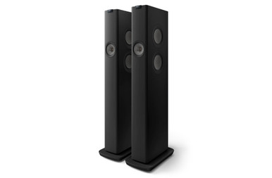

you could just use a phone pre amp and a pair of these beauties.
How dare you. Insult on so many levels I am genuinely offended....Just in case uk sarcasm and satire is misinterpreted... I am joking!
I saw the retirement article for these....
Coupled with wireless for audio streaming....
No expensive cables what will I spend the 2k on.
No amp what will I do with the 3.5k for the amp.
Actually they're on the have a look at list just wasn't sure on how they would work with the vinyl...
Just don't tell a soul.... Interesting the spec support not sure if unserstand this.from the spec on their site.

Doss this mean no matter what is run through theu down sample or in case of vinyl... Shock shock convert to digital playback?
Just an observation. But they are convenient.

Yes it will digitise the signal You could just use this as a phono stage and send it via optical to the speaker input.
Or you could get a pair of Neumann or Genelac active speakers and a streaming preamp like a wiim ultra.

You will need room EQ which is always done via DSP, which means all analog sources need to be digitized
This is no problem however, since a decent AD/DA conversion is audibly transparent. I use room EQ with my Linn LP12/Lingo/Ekos/AT33PTGII/Cambridge Audio Duo analog chain and it sounds perfect to me.
not overly sold on KEF... Reliability, namesake and origin...
If in doubt go for professional monitors by Neumann or Genelec, with a Wiim Ultra or a Waxwing as preamp.
