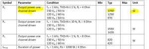

Pro people around audio probably can tell,my installers advised me about 1200as's as a 300W amps despite the brochures (their positive advice was more in line of reliability) .
Same at their datasheet and see how funny it is (I highlighted my use case as I use them in monos for my lows,under 250Hz)
Before
and after :facepalm:

In defense of ICEpower, they do state solid specs in publicly visible datasheets that "everone skilled in the art" can double-check and confirm (which I did). This is OEM stuff and works exactly as advertised, and it's the burden of the implementer to decide whether it's going to be sufficient for the use case or not.
Even giant heat sinks won't make the "2x2000W" ICEpower 2000AS/2 deliver more than 2x280W according to my own tests.
You are absolutely right. I should have checked the datasheet before I ordered my modules....
But they do market them as 2x2000W amps perfect for subwoofers. They are NOT.

Like anywhere else, there is marketing in order to compete and get noticed. I can tell you from personal contact with ICEpower engineers that they were not really happy about this marketing, again like anywhere else ;-)
Still about 2x of what the datasheet says, 2x135W.
These and other ICEpower modules are extensively and successfully used in large active studio monitors when the large short-term power headroom is required to faithfully reproduce uncompressed raw signals and the long-term power is still enough to impress the band in the control room big time ;-)
If you want maximum continuous power from them you need to design proper forced-air cooling, blowing directly over the PCB as well as through a finned heatsink tunnel the module is mounted on. Notably with 110V mains the module itself dissipates almost half the amount of power it delivers to the load, that heat has to go somewhere, quickly....
