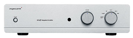

Not many, that's correct. However, @John Atkinson at Stereophile has always been running pre-conditioning, historically at 1/3 rated power into 8ohm, later at 1/8, for one hour, sometimes 30 minutes (AVR). You may check Stereophile amplifier tests. I find them most honest of public audio reviews. This test is IMO even more revealing than the 5 minute rated power test. One example:
I measured the Exposure 3010S using Audio Precision's top-model SYS2722 system (see www.ap.com) for most of the tests, with some use made of the older AP System One. As usual, I preconditioned the amplifier by running both channels at one-third power into 8 ohms, which maximally stresses an amplifier with a class-B or -AB output stage. The normal preconditioning period is one hour, but the Exposure turned itself off after just 20 minutes. While the chassis was warm, the area of the top cover above the internal heatsink was almost too hot to keep my hand on. After the amplifier had cooled down, I turned it on again, and all seemed well. But this does suggest that the Exposure's heatsinking is inadequate for sustained use at levels around 40Wpc, which could well happen if the amplifier is used to provide music at a party.
[bold emphasized by PMA]
Needless to say that amplifiers mostly pass the test. But yes, he does not test the toy boxes.
