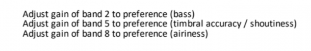

Attached below is oratory1990's PEQ preset for the HE400se, converted to a .txt file which you can load into Equalizer APO using the "Include configuration file" block.
Please add a Preamp block first and set it to -10dB.
Below that, the Include block where you load the preset.
You need to copy the .txt file into C:\Program Files\EqualizerAPO\config for EQApo to be able to read the file.
After you've loaded the preset, you can turn just the EQ On/Off by toggling the Include block On/Off, to listen if you like the change.
To fine-tune the preset, you can click the green arrow in the Include block.
A new tab will open where you can try reducing the 1900Hz filter to +5dB, or try following oratory's instructions:
A new tab will open where you can reducing the 1900Hz filter to +5dB, or follow oratory's instructions:

Keep in mind that changing the EQ values in the green arrow tab will also overwrite the contents of the .txt file
Consider keeping a copy in your downloads folder or elsewhere.
