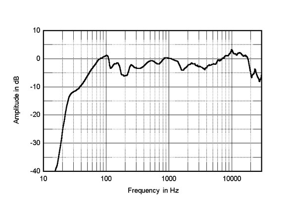

Here is how their $12,000 PMC Fact.8 [signature] measured in the Stereophile review (review from 2020, but released around 2010):
Keep in mind this is a 30-degree horizontal response, so less jagged than on-axis. is also using a close-mic response for the bass which boosts it by like 5dB, so it is more bass-shy than the graphs leads on.
The fact.8 was originally released in 2010 but we reviewed new version, the fact.8 Signature: https://www.stereophile.com/content/pmc-fact8-signature-loudspeaker
Fixed.
