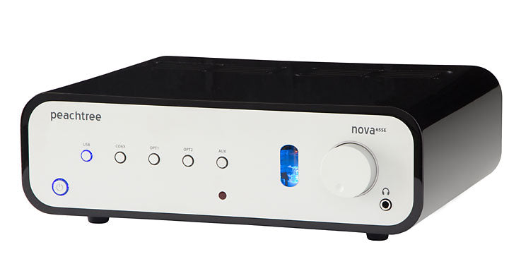

My Carina 150 arrived today. What a beautiful case!
It weights about a 1/3 of the nova65se (judt a guess).

Ok, I noticed that my subwoofer is playing at much lower volume than when it was on the nova65se.
Is this because the carina has to be broken in?
The subwoofer (sb2000) is getting signal, but I had to go and increase the volume on the sub quite a bit.

Then what would cause the subwoofer volume to be so low?
Even with the subs volume maxed, its not as loud as when it was on the nova65se at less than half volume.

There are differences in their preamp output voltage.
Nova65SE :
Carina 150:
The design of the circuit boards inside your two Amps.
If WideEyedToad thinks there is not enough juice in to his sub with the Carina 150. In that case, what do you think about sending the pre amp signal from the Carina 150 to the Nova65SE then the pre out from the Nova65SE to the subwoofer?

I emailed peachtree, hopefully get a response tomorrow. I'm hoping its not a faulty unit.
Do you have a general purpose multimeter? That would be immensely helpful for diagnosis and troubleshooting, also for Peachtree customer support.

I actually talked to peachtree, they said its normal for me to raise the gain..
Also called svs and asked if the sb2000 pro can be paired to the older sb2000, and they said it would work, id just have to match gains. Ordered the pro.
I'm thinking maybe I'll get a splitter cable, and plug the subs into the Wiim ultra instead of the peachtree.
