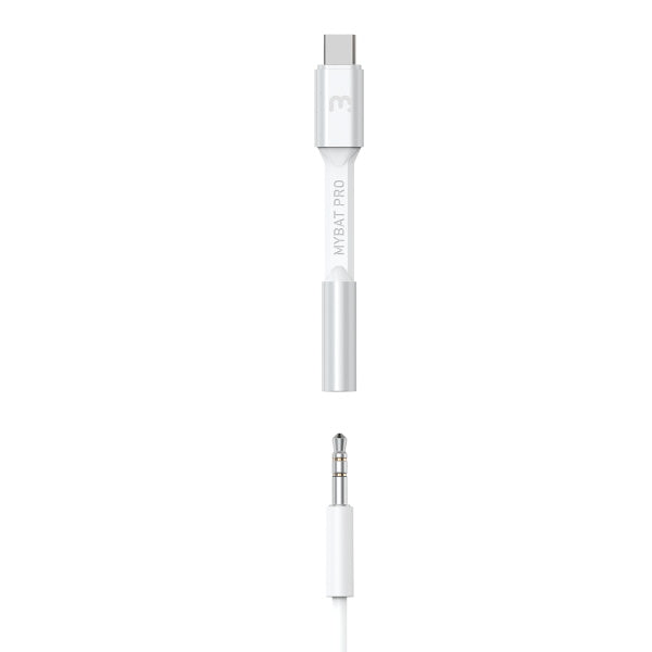

This might be passive, using AAAM (audio adaptor accessory mode);
A few comments say it "didn't work", which may also indicate same.
This doesn't mention conversion, so may also be passive;
JSmith
JSmith
