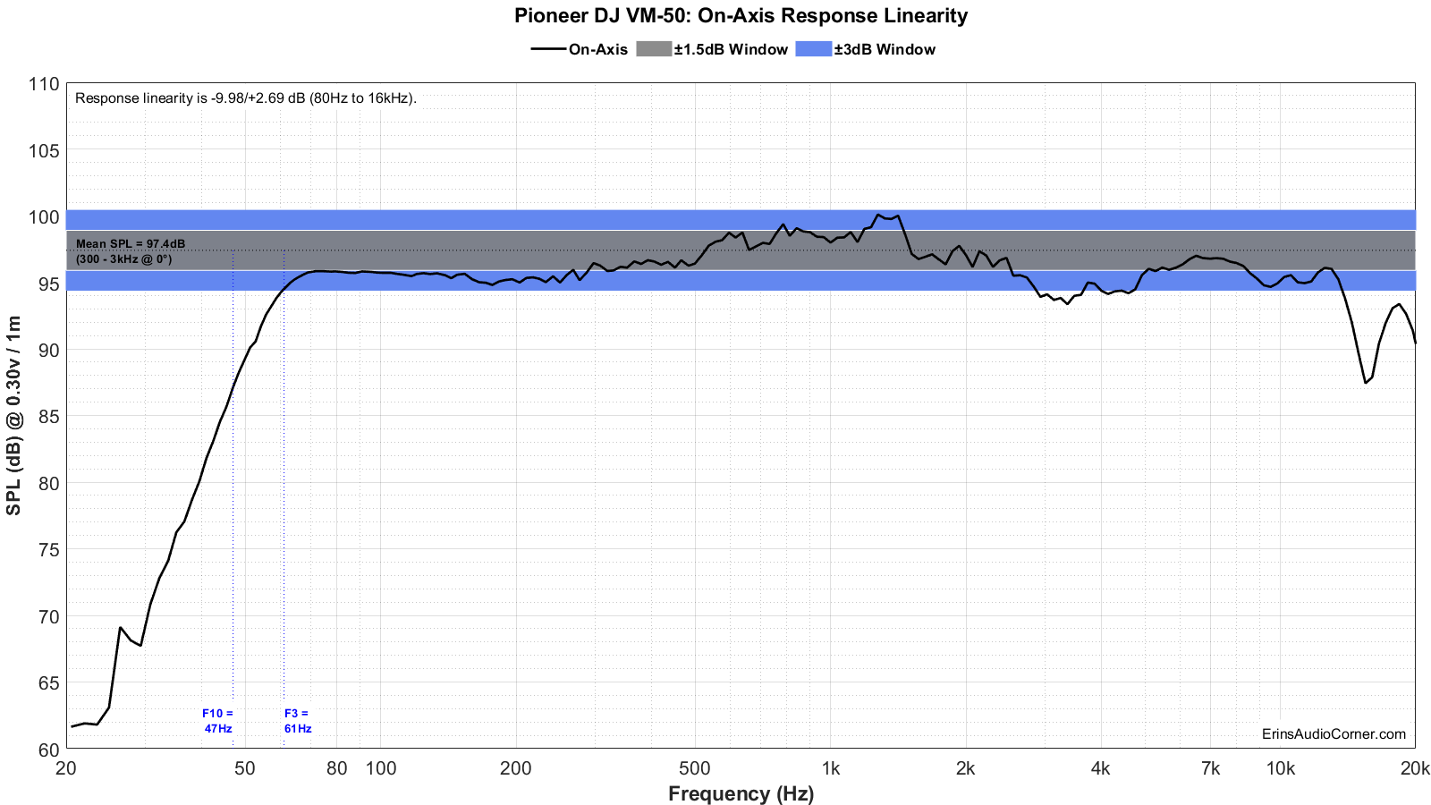

On-Axis Response Linearity

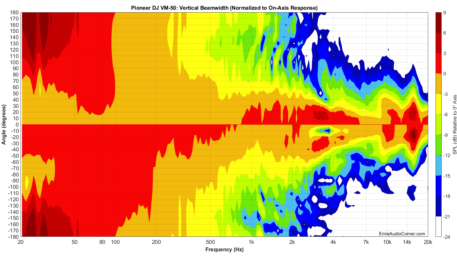

Vertical Polar (Globe) Plot:

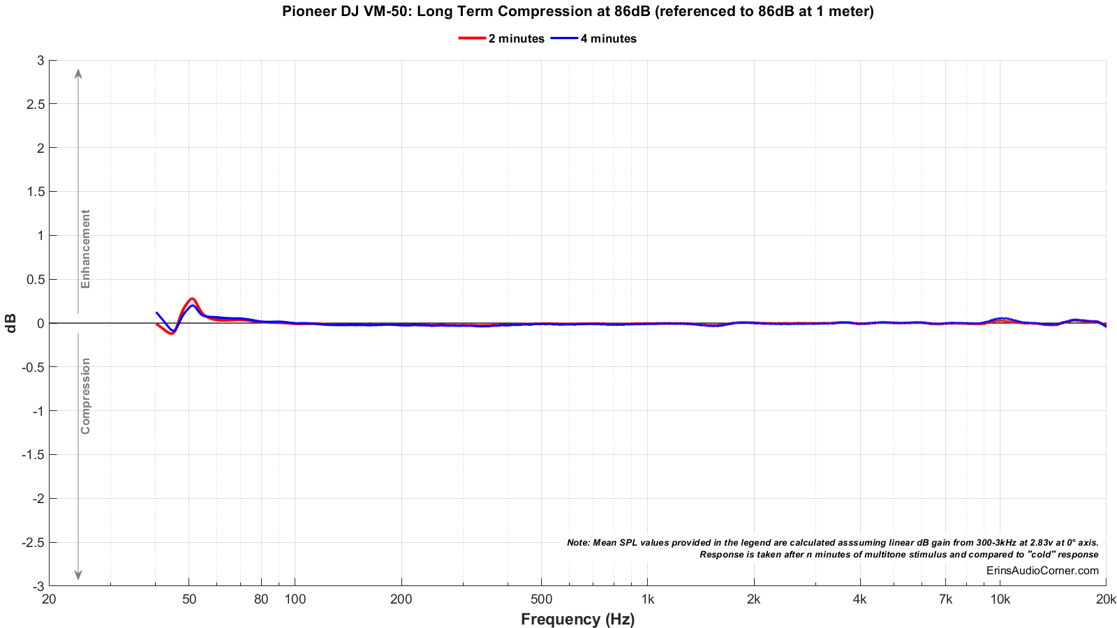

Long Term Compression Tests

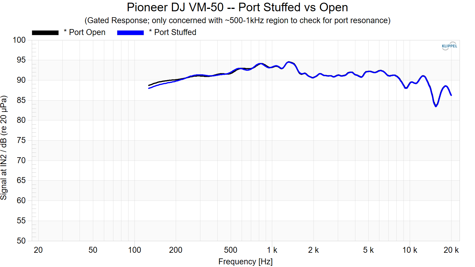

Stuffing the Ports

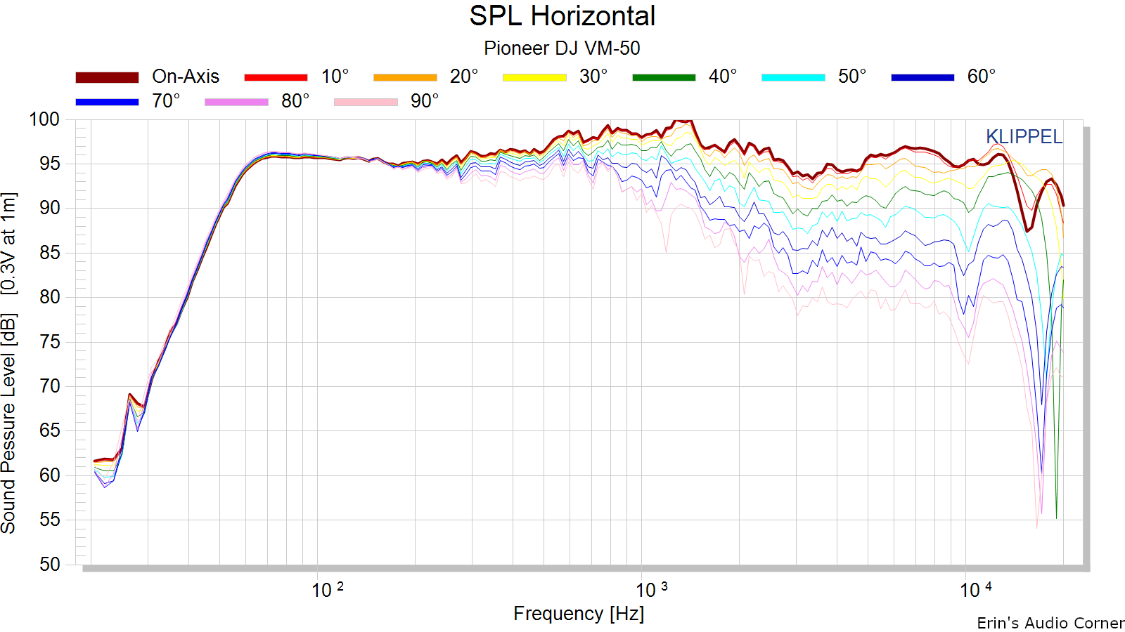

When looking at the SPIN data and the horizontal data, you can see some resonances around 600Hz, 800Hz and 1200Hz. I thought it was possible the port was resonating and sending energy around the speaker through a mechanical means. So, I tested this theory by measuring the speaker with the port open and then stuffing the port. Per the graphic below, there is no difference in the region I am concerned with. This means the port itself is not the cause.
The width of the speaker is about 7.8-inches, but assuming 0.50-inch thick walls, this puts the internal width closer to 6.8-inches. This results in a half-wave of about 1kHz. Figuring the internal dimensions may be a bit off, this leads me to believe what I am seeing is a standing wave inside the enclosure that is simply leaking out of the enclosure in the back. The same assumption applies to all three resonances as the internal dimensions work out to be approximately at these frequencies.
All of that said, these resonances aren’t anything I was actually hearing, at least not to the detriment of my enjoyment of the speaker. Certainly not like other speakers I have experienced resonances with, where in those cases, completely ruined my enjoyment of the speaker. More than anything, it is the sequence of resonances that cause the midrange from 500Hz to 1kHz to be boosted and alter the tonality. In my case, I simply used the built-in EQ of my computer to pad this down about 2dB and it made my musical selection more pleasant to listen to.

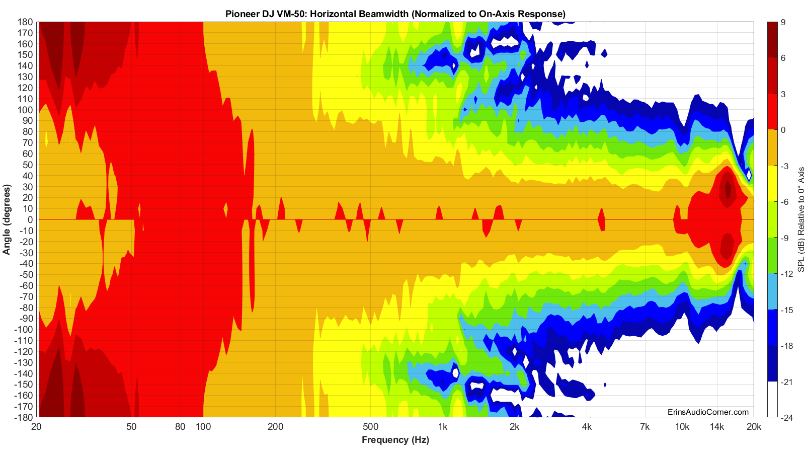

  • Positioning: Horizontally, the 0° axis has a dip (presumably) from the bar grille. If you want, you can toe the speaker in or out a little bit to resolve this. Vertically, you definitely do not want to go below the tweeter axis. The vertical globe plot shows a signficant hole in the response doing this. Even just 10° below the tweeter axis results in a huge dip in response at 3-4kHz. Placing your ears above the tweeter line by about 10° may actually work better.
I do want to mention this, though: Pioneer states these have “flat frequency response". We know that’s a farce.
This is a case where the data does tell an accurate story and we can see that this is definitely not “flat”. It would be easy to dismiss the speaker. Though, when you consider the price and how they are most likely to be used, these speakers are actually pretty good. These aren’t a “home theater” speaker and I can’t imagine anyone would use them in that fashion. Most will use these as computer speakers or with a mixing board. Both of which will almost undoubtedly provide the user with some EQ. Objectively, the 500-1000Hz region’s bumped up output is problematic but it doesn’t ruin the experience. Though, to some degree, the sound does suffer from this. However, if you have the means to add some EQ (I did with Apple Music’s little 1-octave EQ) then you can really transform these speakers into a great budget monitor. I did this and I enjoyed the speaker more as it seems to get rid of both a “forward” sound and “thick” upper vocal. I would personally take them over the JBL 305Pmk2 because of the front baffle resonance issues I had with the JBL.
My recommendation? Buy these, toss a couple bands of EQ from 500-1kHz to bring this down via your music app or mixing board. Try some adjustments in the high frequency region to see what works best for you. And then call it a day.

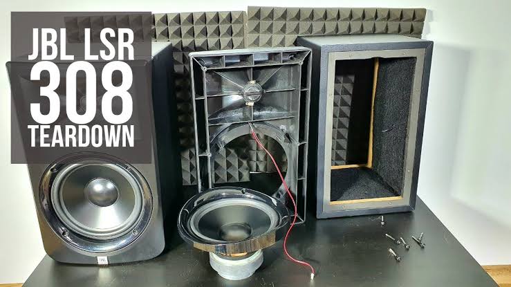

The main issue I find with the JBL LSR series is if you have seen one taken apart, the woofer is mounted onto only the front plastic baffle, which is then mounted to the cabinet using mostly adhesive if I remember correctly.
Here is a picture which kind of shows what going on:
(if you look closely you can see the sealed plastic bits coming off the back of the front-baffle where the screws go)
images
I am not able to find the source but I have seen a picture of the Adam T5V with the plastic front baffle removed and the woofer is mounted with screws into to the MDF like it should be.
