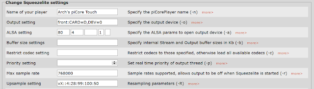

Info on squeezelite resampling:
https://soundcheck-audio.blogspot.com/2011/04/resampling-if-you-cant-avoid-it.html
I use Archimago's settings
http://archimago.blogspot.com/2017/12/howto-musings-playing-with-digital_23.html
Thanks. I removed /etc/asound.conf and rebooted. I hope this isn't getting too tiresome, but I'm still confused about where resampling is taking place. There are 4 places it could take place:
* My squeezebox server (LMS). This uses a sox process for resampling, if needed. My LMS config just passes flac files thru, and no sox process is running during playback (of, say, RBCD files).
* Squeezelite. My reading of the man page is that you have to use the -u or -R flag for resampling to take place, but maybe it does it anyway?

EDIT: Well, alsa is doing the resampling, but only because squeezelite reopens the resampling alsa device when there's a samplerate mismatch. From the squeezelite debug output:
Code:
[00:05:28.205807] _output_frames:152 track start sample rate: 44100 replay_gain: 0
[00:05:28.215785] sendSTAT:195 STAT: STMs
[00:05:28.216042] sendSTAT:195 STAT: STMt
[00:05:28.216166] output_thread:687 open output device: hw:Loopback,0
[00:05:28.216394] alsa_open:351 opening device at: 44100
[00:05:28.217116] alsa_open:381 reopening device hw:Loopback,0 in plug mode as plughw:Loopback,0 for resampling
[00:05:28.217951] alsa_open:422 opened device plughw:Loopback,0 using format: S32_LE sample rate: 44100 mmap: 1
So it first tries opening the hw device at 44100 then reopens it in plug mode.
So it seems better in this case to turn squeezelite upsampling back on with the -R option since this uses the sox resampling library.
By the way, in the case of audio with a higher sampling rate than the max reported to LMS by squeezelite, LMS automatically downsamples using sox based on what squeezelite reports to it:
