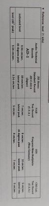

quick measurement.. (virtin pro)
old "lady", year ""80""! ,mm at 155-LC diam (rather ""nos""+sonax)...but not optimized in azimuth adjustment* (see even the other adjustments..)
if I try to use the 1k of ref from the hugaronton.. I found "weird"..
but if I use the dedicated tracks "crosstalk" of the hugaronton (1k 11*10 80mm/s) .. but with at best 40vs 40 less of 0.5db...( fft 48/24 32k)
maybe those who have it could redo this measurement with your homemade scripts?
even if I had decided not to push my settings in lp...d or the "downgrade" bias of old mm "which made me dream when I was young"..
you will finally bring me back (just that unable to use your great homemade "python" scripts etc will only be with my virtins etc, will remain more "modest")
-reedition of x7001 33tr, end 90 "premium",.... 33.5-34 less 0.5db
-with my xg-7001 31db well balanced at less than 0.5db too ..
the azimuth of this cartdrige must not be so bad...
(but at 1khz 3.54cm/s not really jis , special with denon, not 8cm "din"..difference from my "soundcard" etc?, and my at-6605, and him quite disappointing with +-31 vs +-29db...in the same conditions as the denon for example...Japanese approach)

this 3.34-5-8-see 10cm/s... wouldn't it have a serious impact on our observations during the exchanges between us and our different crosstalk acquisition modes? quality of our cards on so low level etc...
ps
in what I have, the hugaroton approach to crosstalk seems the most "thoughtful", accomplished... not talking about my result, but about the proposed test and near 10cm-7.5cm off the lp spin..
(but in the future, I will stick to my denon ... much less strong modulation than the hungaroton therefore less wear and rather coherent and balanced at 1k .the "Japanese" are much more reasonable....)
