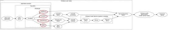

ASIO and WASAPI are specialized Audio playback APIs for Windows.
WASAPI comes in two flavors: Shared and Exclusive.
It is a special attribute of ASIO and Wasapi Exclusive (and technically also Kernel Streaming which is largely obsolete), that they bypass all Windows processing, which includes APOs for signal processing as well as software volume control.
Here's a diagram that may help:
When you use regular "dumb" DACs, then that means that as soon as you enable one of these playback APIs in your playback software (sometimes called by name, sometimes simply "Exclusive mode"), the Windows volume control/slider ceases to function and you get 100% full-blast volume at all times, unless you set Windows to zero at which point the output is muted.
Only the Windows volume is affected by this, so if your playback software has its own, internal volume slider then that will continue working regardless of the chosen API.
At least on modern versions of Windows (10 is the oldest I've ever used so not sure about 7), the OS will detect if the selected USB DAC supports UAC2 hardware volume control, in which case the default volume slider will switch from controlling the volume internally inside the OS, to sending volume commands alongside the audio signal to the DAC, which then applies the volume control/reduction on the DAC chip.
This happens automatically and without any indication to the end user.
Except for the fact that when UAC2 hardware volume is in use and volume control no longer depends on the internal OS processing, it will work exactly the same at all times, regardless of which playback API your software is using and regardless of whether Windows processing is being bypassed or not.
