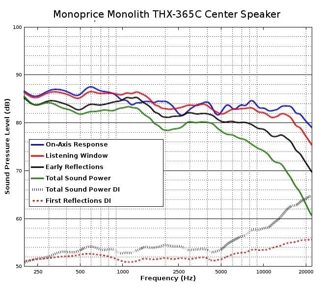

If anyone wanted to purchase the Monoprice THX-365C (3-way center channel), it's currently US$400 (down from $500 or 20% off) at target.com
Just make sure to send it to Amir or Erin first.
Man. Very tempting after his slaughtering of my poor little 520C. It's still a bit too much cash when I can go up into my attic and pull out my JBL s38ii for center channel duties.
