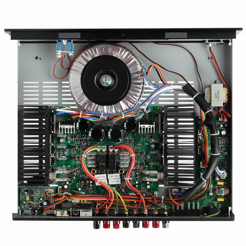

Yeah for the cost it looks quite consumery inside. Not that there is anything wrong with that, but tacking on an extra $400 just for the name is... Its just a conventional amplifier in a 2U rack mount style enclosure.

Looks an awful lot like the internals of my old Rotel 6 channel amp-same binding posts as well.

The design on these dates back to the early 90s with only minor changes. A fair value then, not so good now. An opportunity for those who want a vintage amp with a new warranty.
