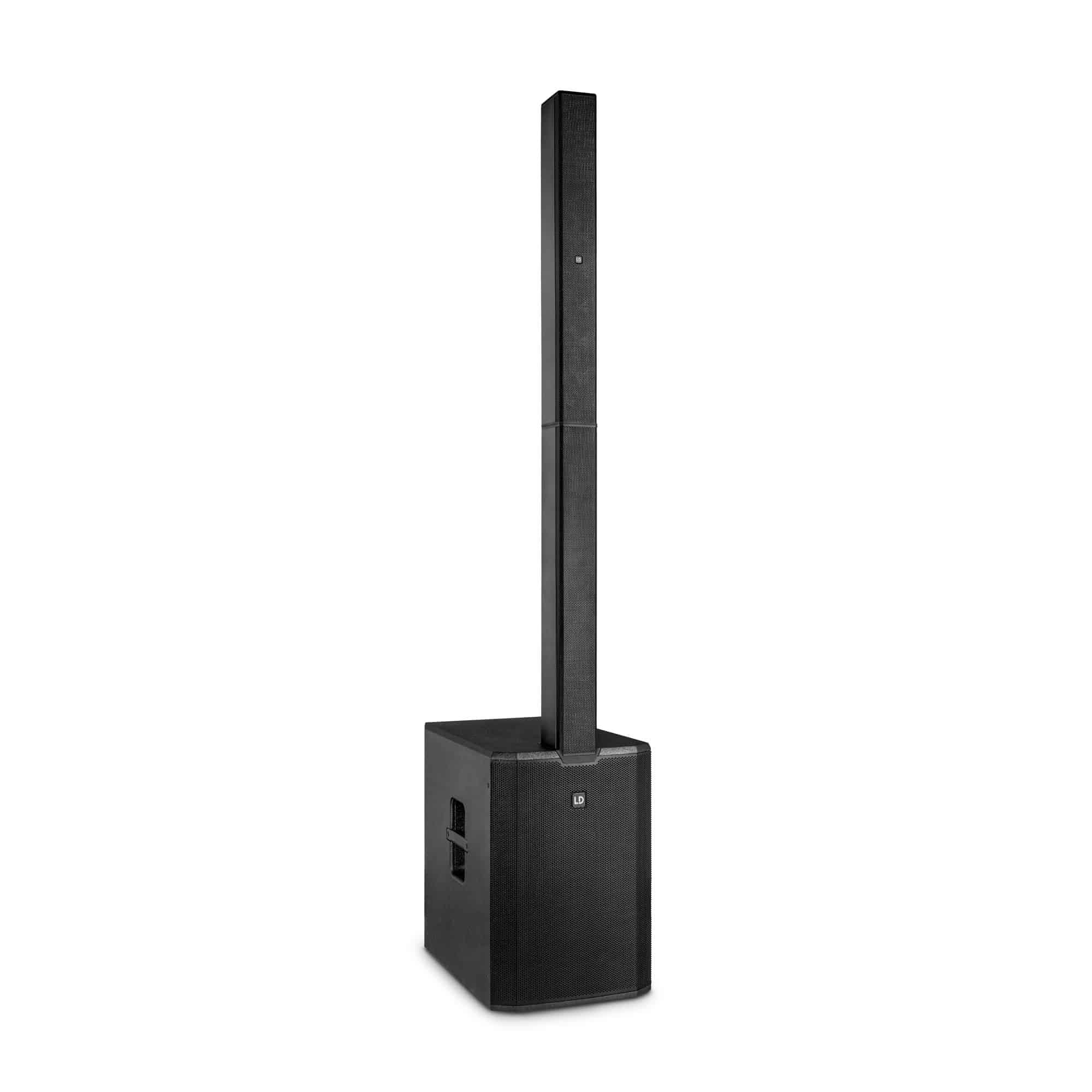

In case anyone wondered how Palmer could release such an advanced product seemingly out of nowhere, look at this speaker from LD Systems (belongs to Palmer). Cardioid midrange and optionally also bass (requires second sub). Check the videos. The way the bass module automatically goes into slave mode, which only allows cardioid mode de-/activation, once the column speaker is removed, showcases their attention to detail and system integration. Also the display reminds me of the Orbits, although the implementation on the latter is more advanced.
View attachment 530185View attachment 530189
This system seems to have been around since 2020. There is even a detailed measurement report on it: https://portal.adamhall.com/api/v1/...download/18a33ad6-f93b-4122-aacb-f5378ee6d28c
Look up their MAILA and CURV systems as well.
All their array speakers are capable of SPL at low distortion that put the hyped up big budget big brand studio monitors around these parts completely to shame.
A weak spot of the MAUI is the sharp transition in directivity from lowmids to midhighs. Otherwise, the objective performance would be frankly ridiculous for the price. But even that could probably be improved with a moderate engineering effort.
Thank you, @Elisando, is there an English version of the German Test/Mesure pdf?
It's on his Patreon, unfortunately.
One more thing: the "mother company" of all of Them is Adam Hall, located near Frankfurt/Germany. You might have seem them from Live Music/Concert accessories like flight cases, but also FOH and professional light equipment. Quite a big company with around 350 - 400/employess. Palmer and LD belong both to Adam Hall.
R&D for all Adam Hall products takes places in the same (and quite fancy) facilities close to Frankfurt.
