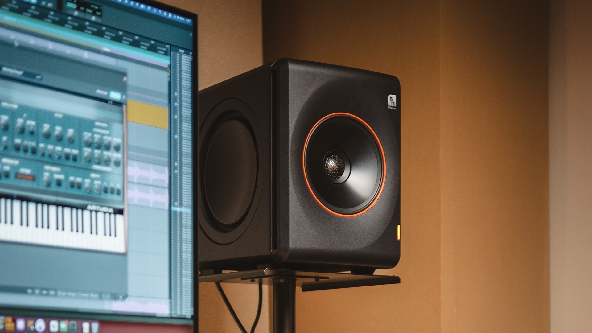

Quite harsch and bad lighting in those photos, but they don't look particularly good, that orange ring with the shiny plastic look make them look cheap. But I guess they have to cut some corners when making a (potentially) really well performing speaker at that low price.

I’m also not a fan of the orange ring or front led. Hopefully the front led can be disabled?

These looks very interesting yes, on perfect almost perfect! Well except for the looks, they need less orange and more wood.
I like their looks too, even if it's less important for me than their amazing techs and specs for the price.
Black and orange match pretty well IMO (a little bit like Mc Laren f1 cars, the only F1 cars with the red Ferrari that don't look ugly to me, since Mercedes has abandonned their beautiful black livery two years ago).
The shiny plastic is the midwoofer cone, so performance characteristics likely outweighed aesthetics there.
Though I'm not a fan of the orange ring either.
I was actually referring to the case of the speaker, which has a rough surface but still quite plasticy shiny.
But of course the material of the cone will affect the performance, but I bet that it could get less glossy without any noticeable difference in sound.
I don't find F1 cars beautiful though, and just generally dislike this modern kind of look and color schemes. Wood is where it's at imo, and if there's any plastic or metal I prefer it to be as matte as possible. But each to their own of course, just hoping for more options in the future if I ever decide on buying these :)
If these were just more pleasing in terms of looks. Just cannot imagine them in my living room. Pro-studio fine, but beyond such dens? Nah, thanks
Black electrical tape on a black speaker will cover that light nicely. Also, works great on Buckeye amp LED.
It has 1000 uses. :cool:
Black tape can do it easily.
Wish the damn orange ring were maybe cobalt blue, or just black though.
Maybe the orange is Palmer's way of mitigating supply/demand complications like Ascilab is having
