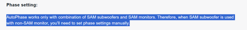

Further from Genelec's Support page: https://support.genelec.com/hc/en-u...c-SAM-subwoofer-with-non-SAM-Genelec-speakers

From the 7360A user manual:

Indeed. The 7360A's Analog Line output (and Only the Line output), can send a high-passed signal.
But that's the full extent of signal processing that the 7360A can apply to its satellite/monitor outputs. No GLM, no phase. Only HPF on analog out.
