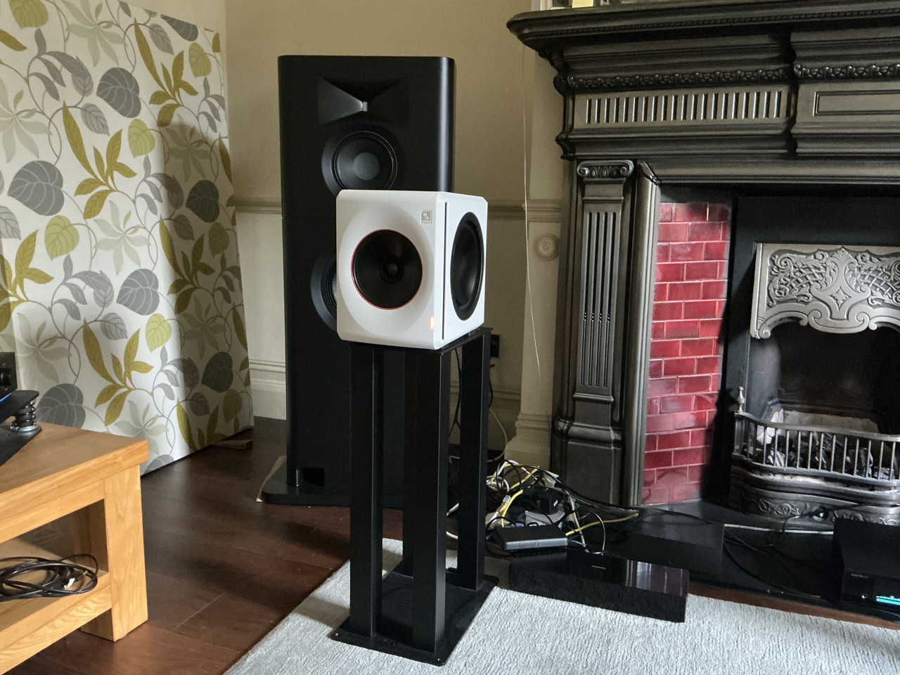

I am sending one away for Klippel measurement.

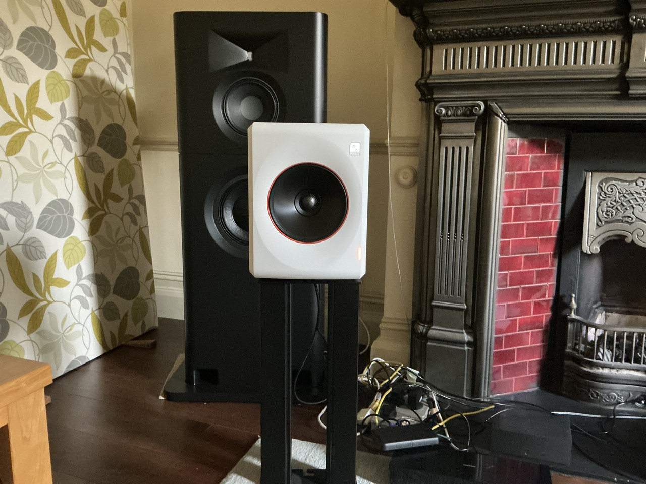

Set-up is an approx 2 metre equilateral triangle, at the moment ‘toed-in’.
They aren’t short of bass!
Set the ‘far from wall’ option and reduced ‘low’ on the ‘PAD” option by -4dB and that is the speakers 1.5 metres away from the front wall.
Good for parties!
Good for parties!
Roughly what are the dimensions of your room, Keith? Subjectively, do they "fill the room".
I still find it amusing that some people (in the main thread) were suggesting that these would not play loud enough to be a HiFi speaker. From your initial listen, Keith, do you think they work as a HiFi speaker? Or is it like the reverse of the example of the (much smaller) active KEF LS50 Wireless being definitely a HiFi speaker and not a studio monitor?
The room is about 5x7m but for compact loudspeakers I usually set them up across the room ( which is the more benign option ) and create a smaller listening triangle as above.
Out of the box they reminded me of the Devialet ‘Phantom’ just too much bass, having said that you can always EQ, better too much than too little.
Just set them firing ‘straight’ which I prefer, Palmer in their instructions show a 30° toe in, ime co-axials tend to sound better straight.
It will be interesting to see the full suite of measurements.
I don’t see any reason why you couldn’t use these domestically, EQ is a must though imho.
Interesting you find the bass too strong as the at hasn’t been reported by others. Unless the others just didn’t mention they had to use the EQ.
Went down to -6dB had quite a few speakers in this room and at those positions A6B for example.

I think I may have been a little too harsh, playing perhaps at a little too enthusiastic a level .
Listening to them this evening they sound fine, perhaps male voices, Leonard Cohen for example have a little less body, I will compare with AsciLabs S6B tomorrow for another perspective.
