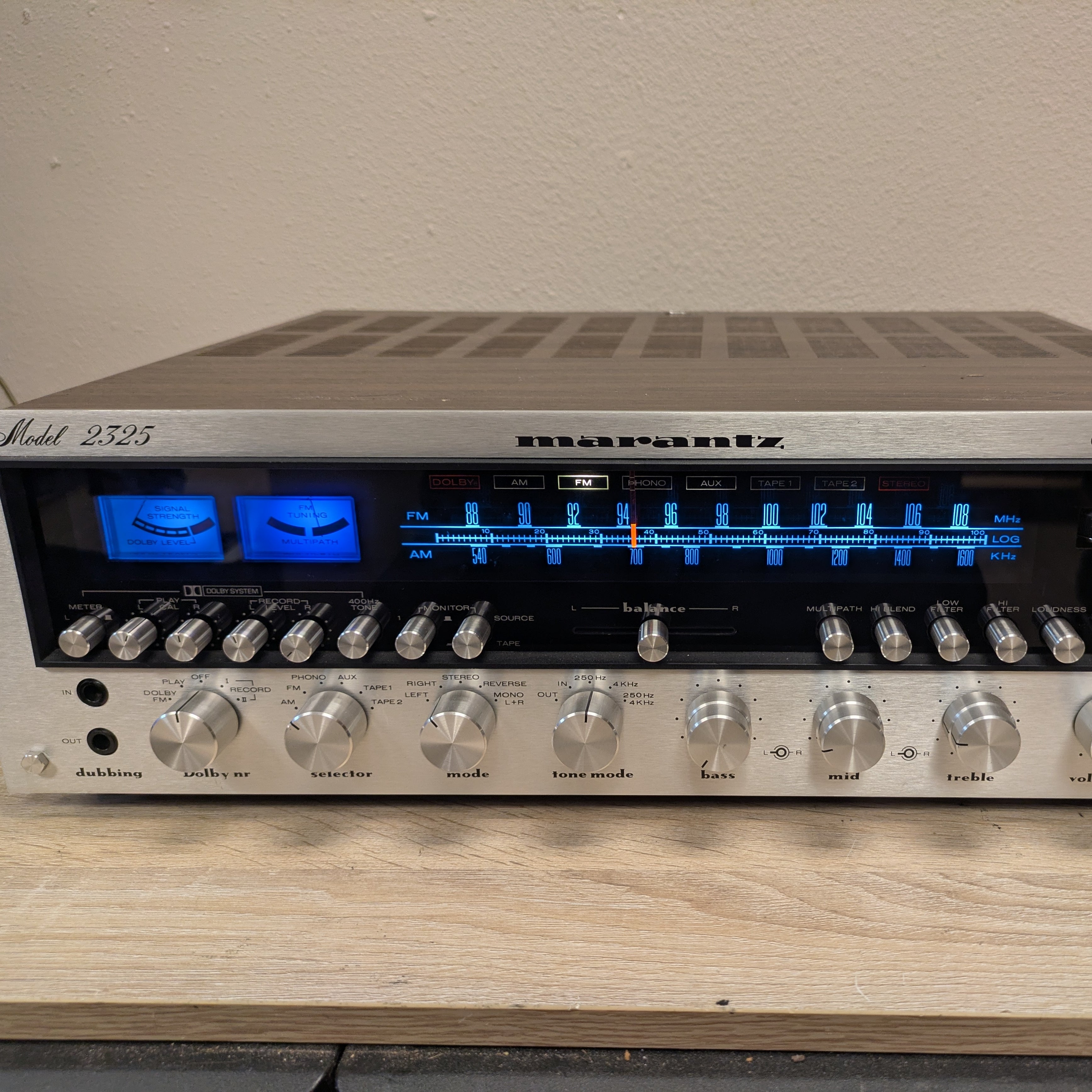

Hello!
I'd like to pair my vintage receiver with a pair of modern tower speakers, but have a low knowledge base where it comes to non vintage speakers.
My current setup is a Marantz 2325 reciever (125 w into 8 ohm ) driving a pair of AR11 speakers, drawing from a turntable, CD player, and streamer.
This would be my 'B' set of speakers, and I'm looking for a non fatiguing, detailed, warm expirence. Second hand (fb marketplace), preferably a wood look, around $500.
Any suggestions happily received to kick me down the path.
Thanks!

That Marantz looks a beauty. It has a tape loop so you could always put a wiim mini in the loop to EQ your speakers to taste.

I second the recommendation to put a WiiM device like a Mini in your signal path via the Tape Monitor loop of the Marantz 2325.
This gives you the option of applying Parametric EQ and room correction to all your inputs - possibly expanding the number of tower loudspeakers you can consider.
WiiM's parent company Linkplay occasionally offers discounts on refurbished WiiM devices at their outlet store on Ebay at the link below - currently no refurbished devices are shown.
BTW, a dealer near me is asking $2,600 for a sample of your beautiful Marantz receiver !

OK, so first: Thanks for the input, very helpful.
I'd like to explore this whole room correction through plugging a wiim into the tape loop.
My room is F#@%ed, to be honest. L shaped with 1 wall against one speaker, and the other about 30 foot away, with all manner of asymmetric furniture in between. I could change the room and lose the wife. Thought about it.
So: the wiim plugs into the tape loop? Is this a closed signal path? How does this work?
Do all signal sources inputted to the receiver travel across the tape loop, into the wiim, room corrected before amplification? How is volume controlled?
This could possibly make a really significant difference to my listening expirence given my terrible room. Its exciting to contemplate.
Thanks again!
Exactly.
Set it up as fixed volume and just use your Marantz as volume control.

Couple of follow ups:
I have a nice DAC (smsl raw pro DAC). Will the wiim color the smsl's output using its own internal DAC, beyond room correction? Ie the smsl dac's signal is being converted a second time?
Or is the wiim room correction separated from the DAC process?
Secondly, is it possible to plug the wiim into the back of the smsl DAC somehow, providing a similar function as per the receivers tape loop? ( and thus not converting / correcting the phono stage analogue signal ) Also, the 2325 is 50 years old. I've never used the tape loop........
Yes it will be converted a second time.
You could
1. run it as a streamer with room correction into the SMSL into Marantz
2. Run the SMSL into the Wiim to add room correction / EQ into Marantz
3. Use it in the tape loop to add room correction / EQ to all sources
This seems highest spec of the small Wiims (the ones without amps or big screens)

I think you will find a WiiM device with the functionality and performance you desire will be a game changer in your system.
A WiiM device in the Tape Loop of your Marantz gives you the option of controlling the volume remotely - IF desired.
FYI, one of my old Bluesound Nodes lacks Bluetooth so I bought a $25 BT transmitter, hooked it to the tape monitor, tape out on my amp and have all the functions of my BT headphones of the BluOS app including volume.
Hmm.
I'm going to have to have a think about all this. Maybe the easiest way is to get a Wiim Ultra and sell off my SMSL raw dac pro, and standalone streamer, as the Ultra has pretty good DAC specs, has a streamer, and of course, room correction. Even has a phone stage which would also be corrected.
Im thinking my system's biggest flaw is the room itself, and any difference between my SMSL and the Ultra would be overshadowed by the potential improvement that room correction affords.
I could get a wiim pro and tape loop it, per the above, but it does make my existing DAC redundant as conversion would drop to the lowest denominator.
DAC specs have improved so much in the last 2 or 3 years, with so much choice (esp the Chinese Dacs), I can see high-quality Streaming Dacs with room correction, like the Ultra, becoming the norm.
