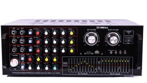

Thanks for replying, these are the speakers:
https://cellandtec.com/products/speaker-omega-x-l07
They are locally made so i guess thats why the price is good but i am battling to get information on them, one DJ though said he is pleased with these speakers. and that it's good deep bass. But that is in a GIG scene.
My setup, just a normal room 15x15 square meters. and occasionally outside (i live on a smallholding)
Can one equalize these speakers out ?
For over 25 years i was happy with my AS-255 sonics speakers, but when i moved out someone punched in the cones of one speaker to my horror the speakers were ruined.
Since then all the towers i've listened to ad friends and some stores did not give that bass and reasonably good clarity i had with these old sonics speakers.
Now i want something that can replace them, but also something that i can play loud often outside occasionally.
Would these Omega speakers above work ?
Here's the amp
