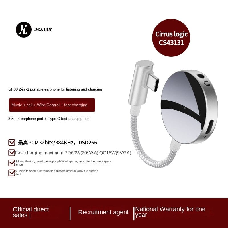

This will work.
Have you tried it with a DAC that needs substantial power? Is the DAC power coming from the charger or the phone? I see they have integrated dacs themselves these cables, not sure if its exactly what I need, I just need data pass-through and enough power for the class AB amp in the DAC.
This one will do that: https://www.audiosciencereview.com/...8d-review-portable-dac-amp.21556/post-1045358
No DAC is built into the hub. Power for your dongle is coming from the charger.

Maybe this one is a better fit?
If you want to attach a usb dac/amp I would not chose a dongle with audio out tho (inconvienient to choose the right output?)
